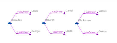

  1. In a link chart, select the entities you want to evaluate to determine whether any relationships are missing. Alternatively, clear an existing selection to evaluate all entities in the link chart for missing relationships.
    A link chart contains a set of entities and relationships.
  2. On the Link Chart tab on the ribbon, in the Scope group, click the Connect button .

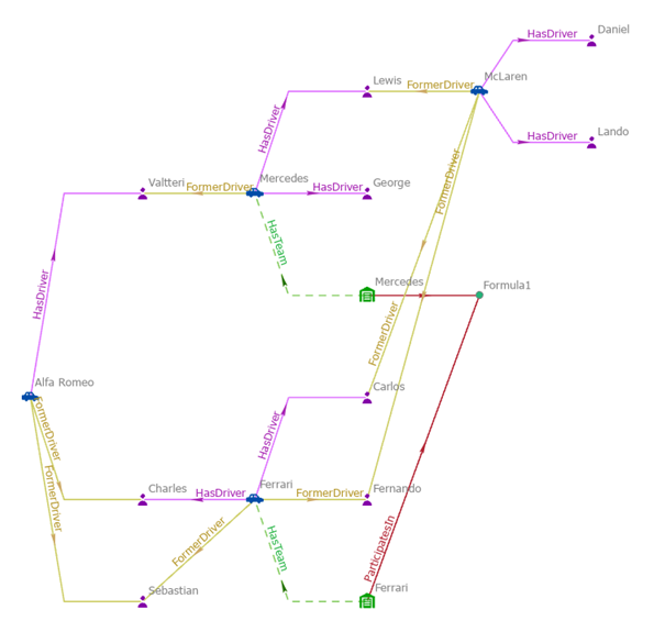

    Missing relationships are retrieved from the knowledge graph and added to the link chart. The existing layout of entities and relationships is modified as needed to accommodate the added relationships. The originally selected graph items are deselected. The added relationships are selected.
    Relationships between entities on the link chart are added if they are not already present.
    Because the added relationships are selected, it can be difficult to see the relationship types.

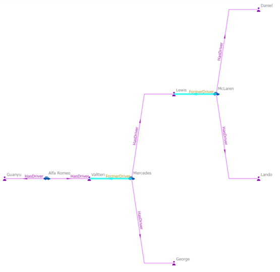

  1. Select 2 to 10 entities between which you want to find the shortest paths.
    Three entities are selected in a link chart.
  2. On the Link Chart tab on the ribbon, in the Scope group, click the Find Paths button .

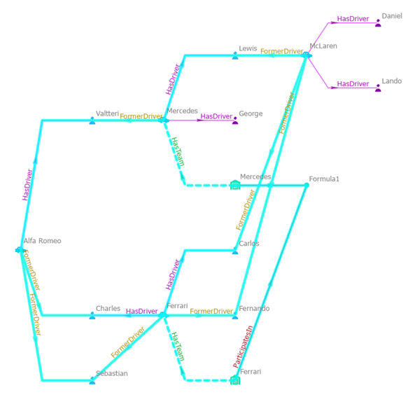

    Entities and relationships representing the shortest paths between all selected entities are retrieved from the knowledge graph and added to the link chart. The originally selected graph items are deselected and the added entities and relationships are selected. When the shortest path includes entities and relationships that were already present in the link chart, these graph items are also selected. The current layout is used to reposition all graph items on the link chart.
    Entities and relationships were added to the link chart and all paths found are selected.
    Because the added entities and relationships are selected, it can be difficult to see the entity and relationship types.

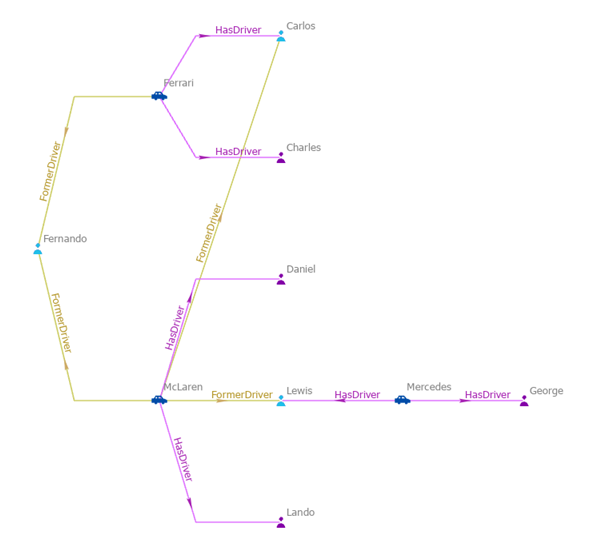

For example, in the graph below, if the origin is the entity E, the destination is the entity C, and the entity B is defined as a mandatory waypoint, the shortest path is the one defined by the highlighted entities and relationships: from E to H to A to B to C. Each entity and relationship is traversed only once and the waypoint filter is satisfied.
The shortest path between entities E and C that includes entity B is the one highlighted on the graph.

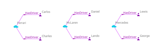

  1. Open a link chart.
    You do not have to preselect the entities and relationships between which you want to find the shortest paths. However, if those graph items are selected, you can quickly reference them when defining the path you want to investigate.
    Entities are selected on the link chart.

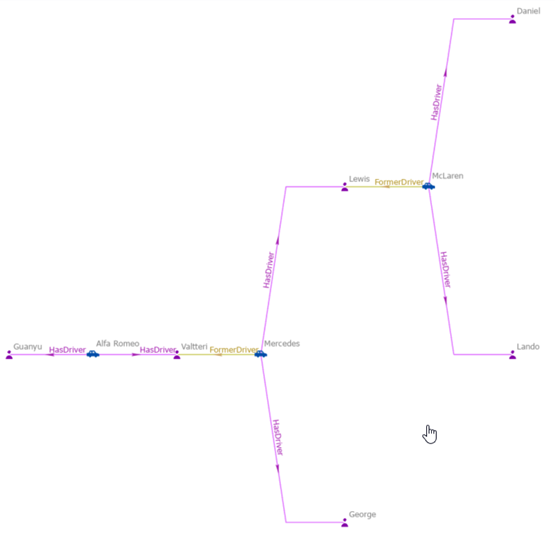

Find entities between entities
The Find Between operation examines the selected entities and determines whether there are entities in the knowledge graph that are directly connected to two or more of the selected entities. Entities directly connected to only one of the selected entities are not considered. Any entity with more than one degree of separation from the originally selected entities is not considered. For example, this can help identify people who are key intermediaries in a social network or crucial suppliers in the supply chain.
If the in-between entities are missing from the link chart, they are added along with the relationships that connect them to the originally selected entities. In contrast, the Select Between operation determines and selects in-between entities using only the graph items present on the link chart; additional entities in the knowledge graph that satisfy the criteria are not added.
The Find Between algorithm only processes selected entities. A minimum of two entities must be selected in the link chart. If an entity group is selected, each entity in the group is processed individually. When the in-between entities are determined, the originally selected entities are deselected and all in-between entities are selected.
To identify the key entities between the selected entities in the link chart, complete the following steps:
  1. Click Find Paths .
    Entities and relationships associated with the result paths are added to the link chart if they are not already present and selected.
  2. Select two or more entities in which you are interested.
  3. On the Link Chart tab on the ribbon, in the Scope group, click the Find Between button .
    Entities directly connected to two or more of the originally selected entities are retrieved from the knowledge graph and added to the link chart if they are not already present. The originally selected graph items are deselected and the in-between entities are selected. If required, the current layout is used to reposition graph items on the link chart.
    Entities directly connected to two or more of the originally selected entities are selected.
