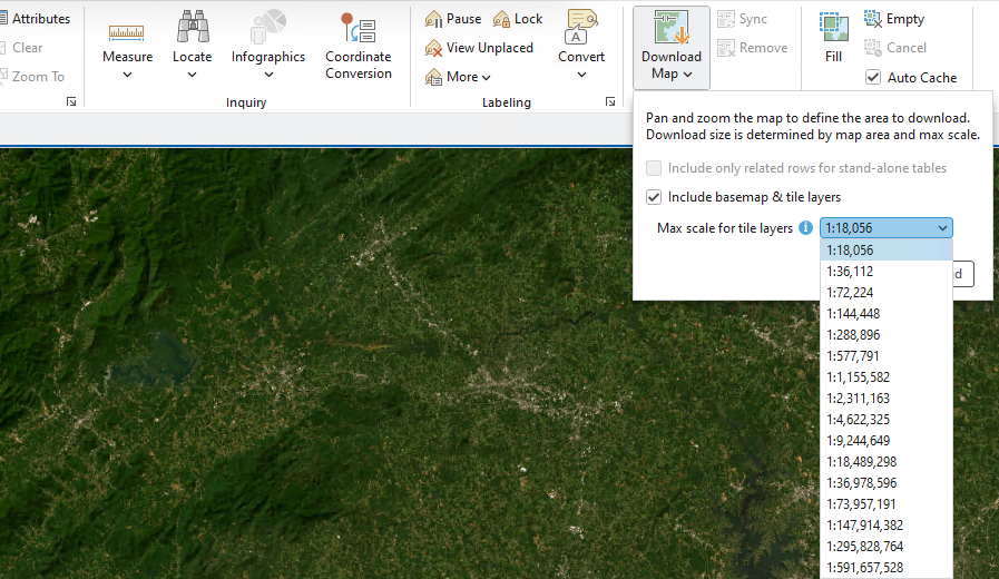

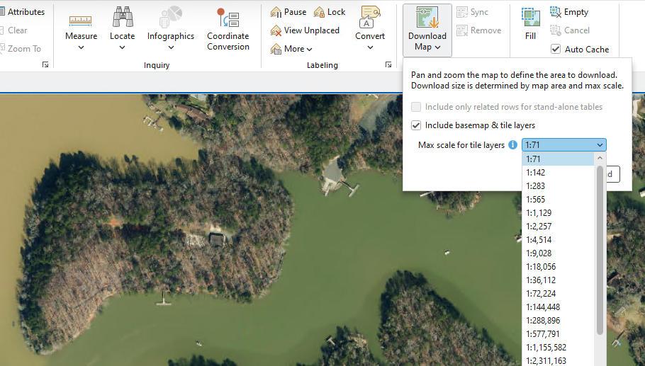

Take tile layers offline
Each tile layer has a maximum number of tiles that can be taken offline. If the map covers a large area, the maximum tile limit will be reached at a given scale. The tiles that are downloaded will be suitable up to that scale and, when you zoom in further, more detail will not be available.
The maximum tile limit is reached at a smaller scale than if you were zoomed in further.
If you zoom in so the map covers a smaller area, you can take more tiles offline before reaching the maximum tile limit, and you will have more detailed reference data to use when you are offline.
Zoom in closer to have more detailed reference data available offline.
At a given map scale, tile layers and vector tile layers can take a different number of tiles offline. The downloaded tile packages and vector tile packages will provide different levels of detail as you work with the offline map.
Vector and raster tile layers have different tile limits at the same map scale.

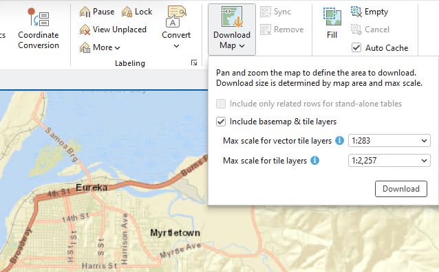

  1. On the Map tab on the ribbon, in the Offline group, click Download Map .
  2. Check the Include basemap & tile layers check box to take these layers offline.
    This option is available only if a basemap or tile layer in the map can be taken offline.
  3. Click the Max scale for vector tile layers drop-down list and choose the largest scale you want to use to download vector tile layers.
  4. Click the Max scale for tile layers drop-down list and choose the largest scale you want to use to download tile layers and imagery layers.
  5. Optionally, zoom in or out on the map to change the scale to use to take tiles offline, and choose a different scale for downloading tiles.
  6. Click Download.
    A progress bar appears while data and tiles are taken offline. Tile layers and imagery layers are downloaded to a tile package. A .tpkx file is created if this format is supported by the service; otherwise, a .tpk file is created. Vector tile layers are downloaded to a vector tile package (.vtpk).
    When the process is complete, packages containing the offline tiles appear in the project's home folder by default. The geodatabase download location can be specified using the ArcGIS Pro sharing and download options. Layers in the map referencing the tile layers that were taken offline are turned off. New layers referencing the offline tile packages and vector tile packages are added to the map.

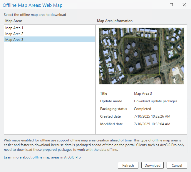

To take map areas prepared ahead of time offline, complete the following steps:
  1. In the Catalog pane, click the Portal tab.
    Alternatively, with a catalog view active, click Portal in the Contents pane.
  2. Browse to or search for a web map or web scene in My Content or another portal collection.
  3. Right-click the web map, and click View Offline Map Areas.
  4. In the Offline Map Areas window, select the desired map area.
    The Refresh button can be used to view the most current content of offline map areas and their status.
  5. Click Download.
    Offline Map Areas dialog box selection window with three available map areas
    If the web map's offline basemap option is set to Tile package on the device, you are prompted to browse to and select a tile package that is already on the local device.
    A progress bar appears while data for the web feature layers is taken offline. When the process is complete, a mobile geodatabase containing the offline data appears in the project's home folder by default. The geodatabase download location can be specified using the ArcGIS Pro sharing and download options. (If multiple web feature layers are taken offline, there are multiple geodatabases.) The geodatabase is added to the project, and a new map is opened with feature layers that reference feature classes in the mobile geodatabase.
  6. Save the project.
