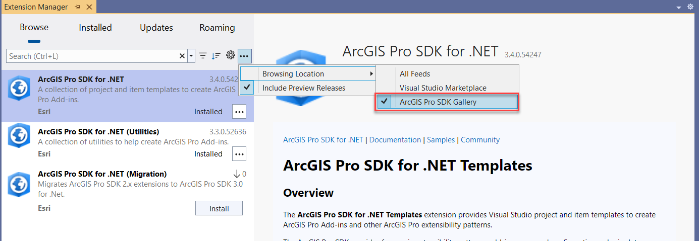

  2. On the Extensions menu, choose Manage Extensions. This will bring up the Manage Extensions dialog.

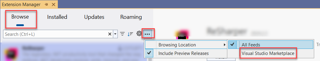

  3. Confirm that the "Browse Location" is set to Visual Studio Marketplace.

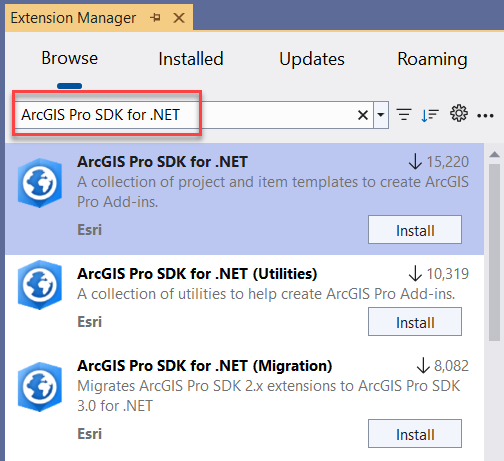

  4. Type ArcGIS Pro SDK in the search box. Among the search results found, the items you will need are ArcGIS Pro SDK for .NET, ArcGIS Pro SDK for .NET (Utilities) and ArcGIS Pro SDK for .NET (Migration) as shown in the following screen shot:

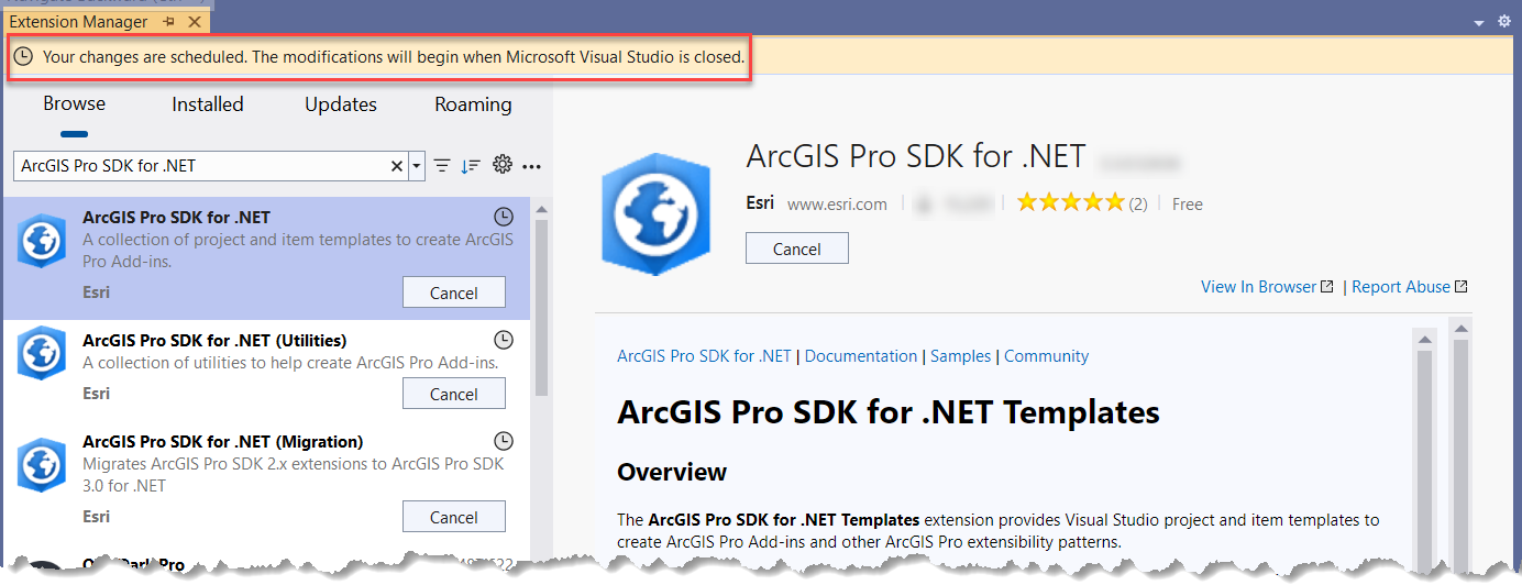

  5. Choose the ArcGIS Pro SDK for .NET package and click the Install button. Optionally, choose ArcGIS Pro SDK for .NET (Utilities) and ArcGIS Pro SDK for .NET (Migration) and click the Install button for each of these extensions. This will allow you to download and install all three extensions in one step.

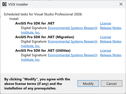

  6. ArcGIS Pro SDK for .NET will be scheduled for install when Visual Studio windows are closed. SDK_Install.png
  7. The VSIX Installer dialog will appear. Click Modify to install ArcGIS Pro SDK for .NET. Proceed with the VSIX Install wizard to complete the installation.

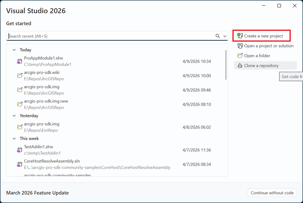

  8. Verify that the ArcGIS Pro SDK for .NET templates and utilities are installed in Visual Studio.
    • Access the Create New Project option from the Visual Studio start window.
      Filter all the available Project templates by using custom ArcGIS Pro SDK Project Type Filter. You should see ArcGIS Pro SDK templates. ArcGIS_Pro_Addins.png

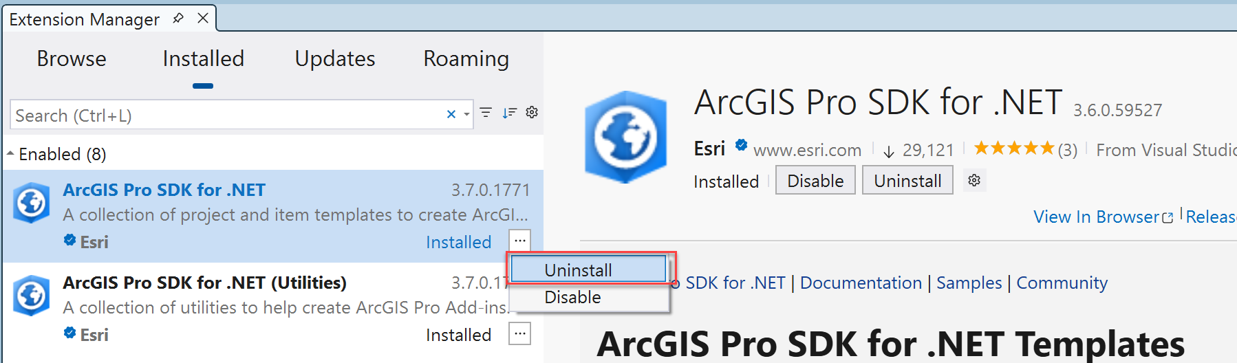

  1. Start Visual Studio. On the Extensions menu, choose Manage Extensions. This will bring up the Manage Extensions dialog.
  2. Click the Installed tab at the top.
  3. Find the ArcGIS Pro SDK for .NET, ArcGIS Pro SDK for .NET (Migration) and ArcGIS Pro SDK for .NET (Utilities) packages and click the ellipsis button and select Uninstall.
