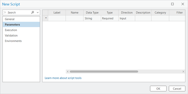

  7. In the list of side tabs, click the Parameters tab.
    The dialog box appears as follows:
    Define the script tool parameters
    1. Define the tool parameters in the Parameters tab.
      Almost all tools have input parameters, and all tools must have an output parameter to be used in ModelBuilder.
      To learn more about defining parameters, see Setting script tool parameters.
