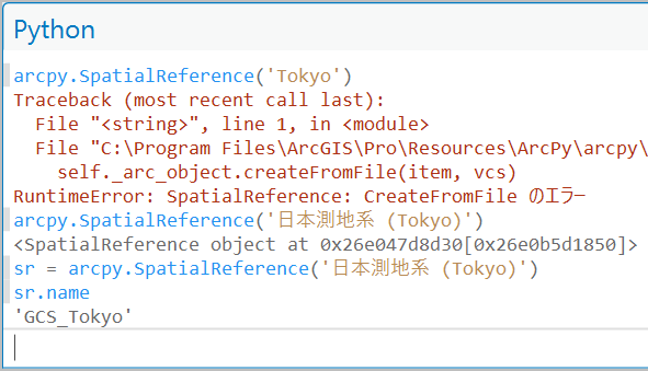

  • Using the display name of the coordinate system.
    This method should be avoided if the code will be run on different locales or language packs.
    # EPSG:4301 Tokyo
    sr = arcpy.SpatialReference("Tokyo")
    The following depicts code run on a Japanese language pack. Using an English spatial reference display name does not work and returns an error. Each language pack will have a uniquely translated display name; however, the canonical name and factory code will remain constant regardless of language or locale.
    Python window in Japanese language pack with spatial reference example
