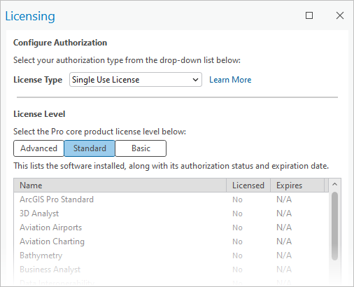

  3. On the Licensing dialog box, click the License Type drop-down arrow and click Single Use License.
    Note:
    If you encounter the following message, it means that ArcGIS Pro was installed with the per-user option rather than the per-machine option:
    This functionality is not available without the ArcGIS Licensing Service being installed. The service can be installed by running the license service installer located within the ArcGIS Pro installation folder.
    The per-user option does not include the ArcGIS Pro Licensing Service, which is needed to authorize a Single Use license. To install the ArcGIS Pro Licensing Service, run ArcGISLS.msi in the C:\Users\<user profile>\AppData\Local\Programs\ArcGIS\Pro\Resources\ArcGIS Licensing Service folder.
    If you have installed ArcGIS Pro using the per-machine option, the ArcGISLS.msi file is located in the [ArcGIS Pro install directory]\ArcGIS\Pro\Resources\ArcGIS Licensing Service folder.
  4. Under License Level, click the license level you will use: Advanced, Standard, or Basic.
    In this example, a Standard license level is selected.
  5. Click Authorize to open the Software Authorization Wizard dialog box.

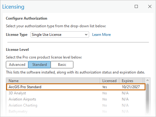

    When the process finishes, a message on the Software Authorization Wizard dialog box indicates that the software is authorized and ready for use.
  12. Click Finish.
    The ArcGIS Pro Licensing dialog box remains open. In the list of products, ArcGIS Pro is now licensed.
    ArcGIS Pro is licensed on the Licensing dialog box.

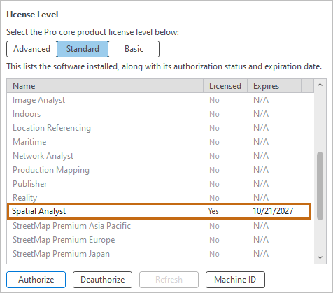

  8. On the Authorize Software Extensions page, click the extension to authorize. Click in the Authorization Number column and enter the authorization number.
    Spatial Analyst extension with authorization number in the Software Authorization Wizard
  9. Click Next.
    When the process finishes, a message on the Software Authorization Wizard dialog box confirms that the software has been authorized and is ready for use.
  10. Click Finish.
    The ArcGIS Pro Licensing dialog box remains open. In the list of products, the extension is now authorized.
    Spatial Analyst extension licensed on the Licensing dialog box.

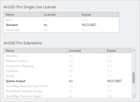

  1. Start ArcGIS Pro if necessary.
  2. On the ArcGIS Pro start page, click the Settings tab . Alternatively, if you have a project open, click the Project tab on the ribbon.
  3. On the settings page, click the Licensing side tab.
    Single Use license information in ArcGIS Pro
    The three ArcGIS Pro license levels (Basic, Standard, and Advanced) are displayed under ArcGIS Pro Single Use License. Your license level displays the Yes value in the Licensed column.
    Extensions appear under ArcGIS Pro Extensions. You are licensed to use any extension with the Yes value in the Licensed column.
