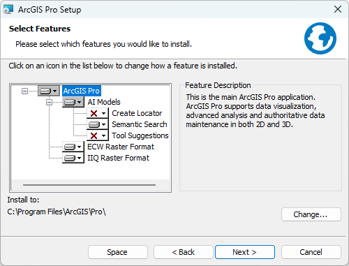

    Select Features panel with default settings for a new installation
  10. Accept the default or choose which features you want to install.
    • To install all AI model features, click the AI Models drop-down arrow and click This feature, and all subfeatures, will be installed on local hard drive.
    • To install a particular AI model feature, click its drop-down arrow and click This feature will be installed on local hard drive.
    • To block installation of a feature, click its drop-down arrow and click This feature will not be available.
    Semantic Search is installed by default for new installations of ArcGIS Pro. If you are upgrading a machine that already has ArcGIS Pro installed, the setting from the previous installation is used. Other AI models are not installed by default. None of the AI models use generative AI.

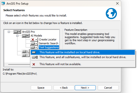

  5. In the Select Features panel, click the drop-down arrow for an individual feature, and choose the setting you want.
    Select Features panel on the ArcGIS Pro Setup wizard
    In this example, the setup is modified to enable tool suggestions.
