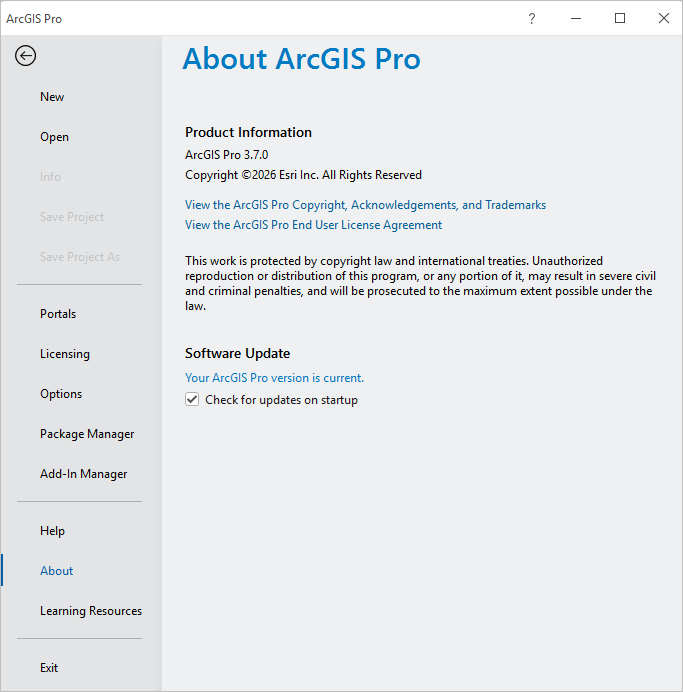

  5. When a prompt indicates that the update succeeded, click Yes to start ArcGIS Pro.
    In the ArcGIS Pro settings, the About ArcGIS Pro page indicates that your software version is current.

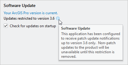

  4. To confirm the setting, open the ArcGIS Pro settings page in one of the following ways:
    • From an open project, click the Project tab on the ribbon.
    • From the start page, click the Settings tab .
  5. In the list of side tabs, click About.
    About ArcGIS Pro page showing software updates restricted to version 3.4
    On the About ArcGIS Pro page, under Software Update, a message confirms that updates are restricted to the specified version.
