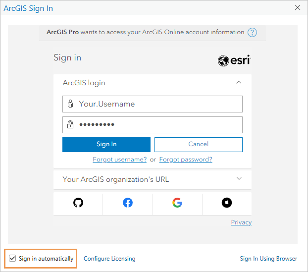

    The ArcGIS Sign In window appears.
  2. Type your username and password.
    Your username and password for ArcGIS Pro are the same as those for ArcGIS Online.
    The Sign in automatically check box is checked by default. As long as you leave this box checked and don't sign out of ArcGIS Pro, you will not need to sign in the next time you start the application.
  3. Click Sign In.

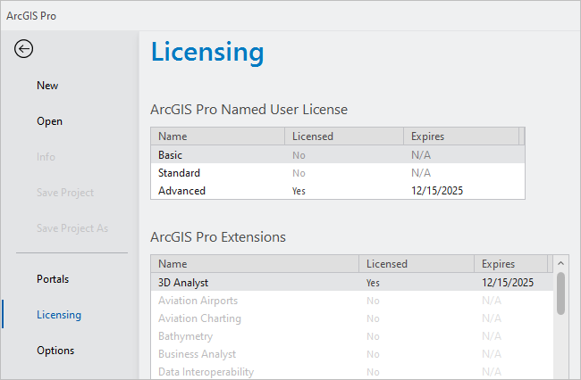

  1. On the ArcGIS Pro start page, click the Settings tab . Alternatively, if you have a project open, click the Project tab on the ribbon.
  2. In the list of side tabs, click Licensing.
    License information in ArcGIS Pro
    The three ArcGIS Pro license levels (Basic, Standard, and Advanced) are displayed under ArcGIS Pro Named User License. Your license level is the one with the Yes value. In this example, the license level is Advanced.
    Extensions are displayed under ArcGIS Pro Extensions. You are licensed to use any extension with the value Yes in the Licensed column.

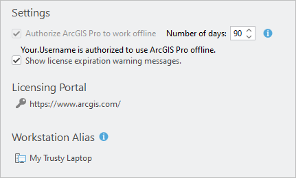

  3. Choose a descriptive workstation alias if you haven't already done so.
    1. Next to Workstation Alias, click Edit.
    2. On the Edit Alias dialog box, type a name that helps identify the computer you're using to take ArcGIS Pro offline. Click OK.
    A descriptive workstation alias helps your organization administrator view license details and keep track of which computers—not simply which users—have an offline license. This can be useful if a computer is lost or damaged and a new license needs to be obtained.
  4. Under Settings, optionally adjust the number of days to take the license offline.
    Settings for offline license use
    The maximum number of days is set by your organization administrator. You cannot exceed this number.

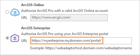

  3. Click Configure your licensing options.
  4. On the Licensing dialog box, under Configure your licensing options, click ArcGIS Online or ArcGIS Enterprise according to the type of organization that will manage your license.
  5. In the URL box, specify the portal URL:
    • For ArcGIS Online, you can use either https://www.arcgis.com/ or the URL of your organization, which has the form https://organizationname.maps.arcgis.com/.
    • For ArcGIS Enterprise, the URL has the form https://webadaptor.domain.com/webadaptorname/.
    Portal options on the Licensing dialog box
    Note:
    If you use an ArcGIS Enterprise portal, do not include www. in the URL.
