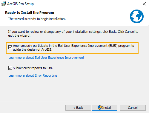

Participate in the EUEI program
When you install ArcGIS Pro, one of the preliminary steps prompts you to participate in the EUEI program. By default, the check box to participate is selected. If you don't want to participate, uncheck the check box before proceeding.
The Esri User Experience Improvement program check box on the installation wizard panel is checked.
