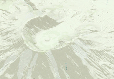

As an example to help you understand how to use these tools to conduct a skyline analysis, the graphic below shows a birds-eye view of the Mount St. Helens crater. Imagine that there is an observer standing in the bottom center of the crater looking around. You want to analyze the horizon from the observer point around the top of the crater. You can create a 3D line depicting the locations that are visible from the observer point and then quantify it. To do this, you can start by running the Skyline geoprocessing tool to create the 3D horizon line. The skyline might be similar, but not identical, to the ridgeline.
The study area of Mount St. Helens crater is shown.

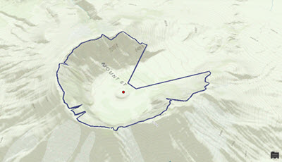

The result of running the Skyline geoprocessing tool is shown.
The red dot in the center of the crater represents an observer standing at the bottom center of the crater. The dark blue line is the output of the Skyline geoprocessing tool, which shows how far the observer can see, in all directions, around the surface.

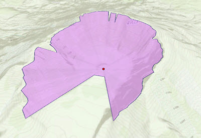

The Skyline Barrier geoprocessing tool generates height control surfaces from skylines. They are defined between observation points and the skylines associated with these points. A barrier can be used to detect whether a feature of interest is above the horizon, and therefore visible, or would modify the skyline if incorporated into the scene. The tool can also generate a shadow volume, which can in turn be used to determine whether features are shaded or hidden by the features, or surface, used to generate the skyline from which the barrier was created.
You must provide two inputs to the tool: one is the observer point, and the other is the skyline, which is a 3D line that you generated from the output of the Skyline geoprocessing tool that you used previously. In the graphic below, you can see a red dot, which is the input observer point, and the is the skyline barrier created, which is a multipatch feature created by the tool. The composition of this multipatch feature is a collection of triangles emanating from the center observer point.
Skyline Barrier results
The results of the Skyline Barrier tool are shown.

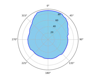

Like the Skyline Barrier geoprocessing tool, the Skyline Graph geoprocessing tool requires an observer point and a skyline as inputs. The output is a polar graph and an optional table. The following image is the polar graph output from Skyline Graph. The blue area shows the sky exposure, which is what you would see if you lie on your back and look up to the sky. The center of the graph is at the observer point. The angles surrounding the graph represent the azimuth from the observer, and the angles on the concentric rings are the zenith angle (the larger the zenith angle, the more sky that can be seen in that horizontal direction).
Polar graph
Polar graph output from the Skyline Graph geoprocessing tool is shown.

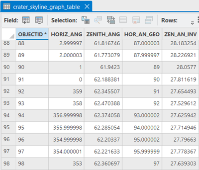

The table below shows the output table from the Skyline Graph geoprocessing tool. The fields are defined as the following:
  • HORIZ_ANG—Arithmetic angle, starting from east at 0 degrees and going counterclockwise, which ranges from 0 to 360 degrees.
  • ZENITH_ANG—Angle from top down, which ranges from 0 to 90 degrees.
  • HOR_AN_GEO—Geographic angle, starting from north at 0 degrees and going clockwise. Its value is calculated using the formula:
    \(Geographic \space = \space (450 \space - \space Arithmetic) \space mod \space 360\)
    , which ranges from 0 to 360 degrees. Mod 360 indicates that if the number to its left is 360 or greater, subtract 360 from that number.
  • ZEN_AN_INV—Angle from bottom up, which ranges from 0 to 90 degrees. It's complementary to ZENITH_ANG, meaning that 90 is the combined value.
Skylines Graph output table
Table output from the Skyline Graph geoprocessing tool is shown.

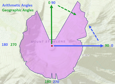

The first pair consists of horizontal angles. The values in the HORIZ_ANG column are arithmetic angles, where 0 represents due east and the angle increases counterclockwise. HOR_AN_GEO is an azimuth or geographic angle; its origin 0 is due north, and it increases clockwise. The following graphics may help in understanding these concepts.
This is a map view, or orthographic view. For the Mount St. Helens crater, the opening is to the north, with the azimuth/geographic angle at 0 and arithmetic angle at 90, as shown in the image below.
Skyline Graph Example
Angle values show results from the Skyline Graph table.
To obtain geographic azimuth from arithmetic angle, the following formula is used:
For example, for an arithmetic angle of 180 (west), the geographic angle is
\((450 \space - \space 180) \space mod \space 360 \space = \space 270 \space (west)\)
. For an arithmetic angle of 30 (east northeast), the geographic angle is
\((450 \space - \space 30) \space mod \space 360 \space = \space 420 \space mod \space 360 \space = \space 60\)

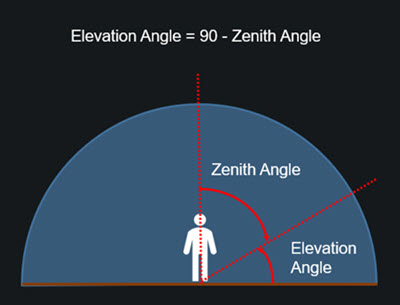

The second pair consists of vertical angles, as you can see from the above table in the ZENITH_ANG and ZEN_AN_INV fields, which are complementary. Their relationship is much simpler and can be illustrated with the image below.
The relationship between elevation angle and zenith angle
The relationship between elevation angle and zenith angle.
