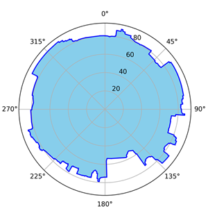

  • This tool requires the line features created by the Skyline tool and generates a polar graph. The polar graph can be seen in the tool's message window and can be also be saved as an image. The output message also indicates the percent of visible sky above the horizon.

  • The tool will report the minimum and maximum vertical angles of visibility to the sky along with the sky visibility ratio, which is expressed as a value from 0 to 1. A visibility ratio of 0.8 indicates that 80 percent of the sky is visible.
  • The percentage of visible sky will be included in the results. This value is equal to the area above the skyline, divided by the area above the Base Visibility Angle parameter value and is calculated only within the azimuth range of the skyline.
