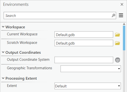

You can specify geoprocessing environment settings once for your project using the Environments window. These settings are saved with your project and will be automatically used by all tools that honor the environments. Open this window by clicking Environments on the Analysis ribbon tab.
Geoprocessing Environments window
The geoprocessing Environments window is shown.

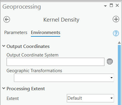

Only certain environment settings will be used by a given geoprocessing tool. To determine the environments that a tool will use, consult the Environments section of the tool's reference page. You can set environments individually for any tool that you open in the Geoprocessing pane by switching to Environments. These settings will only be used until the tool is closed, and will not be saved if the tool is opened again, unless the tool is opened from Geoprocessing History. Not all geoprocessing environments are listed in tool Environments—only those that the tool supports.
Environments tab of a tool dialog box
Environments used by the Kernel Density tool are shown.
