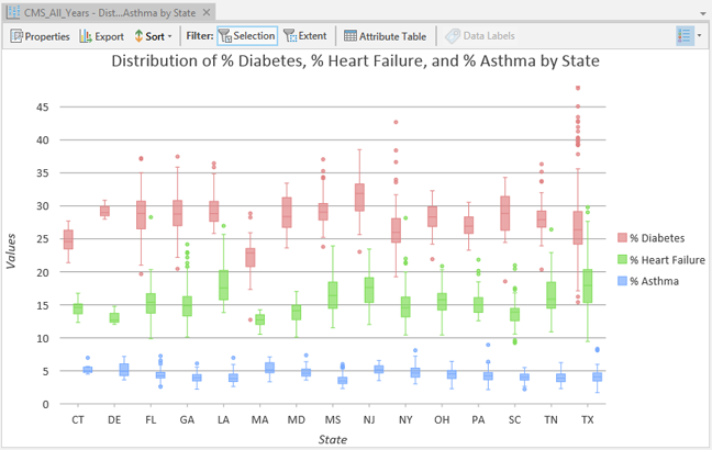

Example
Create a box plot to compare the distributions and variability of chronic health conditions by state using the following settings:
  • Numeric fields—% Diabetes, % Asthma, % Heart Failure
  • Category—State
Box plot comparing the distributions and variability of chronic health conditions by state
