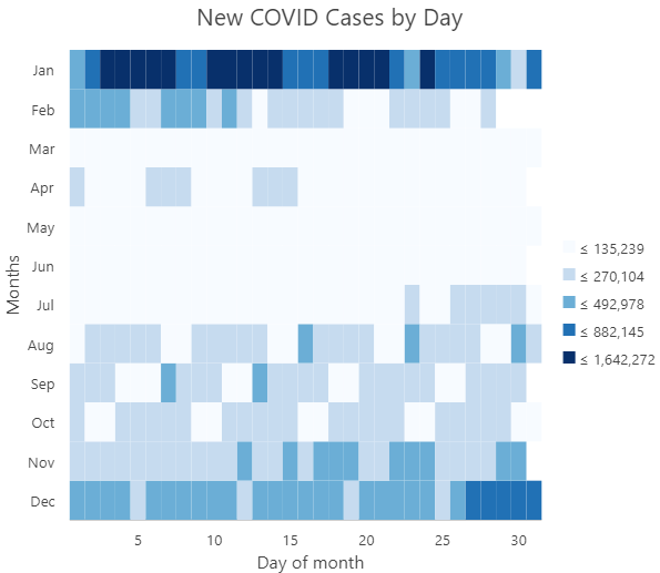

Calendar heat charts visualize patterns in temporal data by aggregating incidents into a calendar grid. Calendar grids can be configured to display temporal patterns across the months in a year or across the days in a week.
In a year view, each row in the calendar grid corresponds to a month, and each column corresponds to a day of the month.
Calendar heat chart month grid

When displayed as a single calendar view, each cell in the calendar heat chart corresponds to the specific calendar unit defined by the intersection of the row and column, and all incidents sharing those two dimensions will be aggregated into the same cell. For example, when aggregating a dataset spanning multiple years into a single year view, all incidents with the dimensions October and 22 will be aggregated into the same cell, regardless of year. Similarly, when aggregating a dataset spanning multiple weeks into a single week view, all incidents with the dimensions Wednesday and 12pm will be aggregated into the same cell, regardless of week number. This single calendar view reveals typical day-of-month or hour-of-day patterns found by summarizing many time spans into one calendar.
Calendar heat chart shown as a single calendar view.

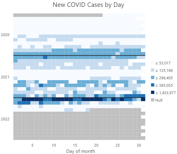

Alternatively, calendar heat charts can display sequential calendar views to visualize what took place in each individual year or week. For example, when visualizing a dataset spanning multiple years as consecutive calendars, a unique calendar grid is drawn for each year. A sequential calendar view helps reveal patterns that occur on specific years or weeks across a linear time span.
Calendar heat chart shown as sequential calendar views.

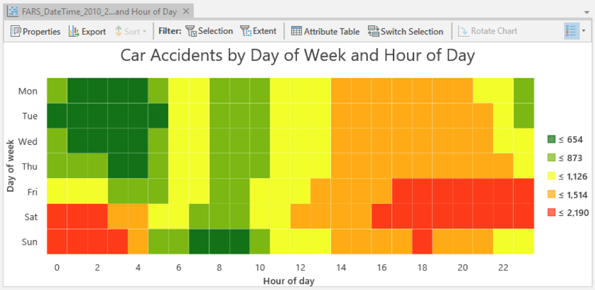

Example
Create a calendar heat chart to identify which days of the week and during which times of day most car accidents take place.
  • Date—Date
  • Calendar type—Week by day of week and hour of day
  • Aggregation—Count
  • View type—Single calendar view
Calendar heat chart showing patterns in car accidents by day of week and hour of day.
