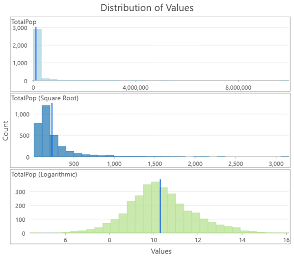

You can create multiple series histograms in one of two ways. Selecting multiple Number variables will create a new histogram series for each field and transformation selected. For example, you may add the same variable multiple times to compare the effect different transformations have on the distribution.
Comparison of different transformations on a single variable

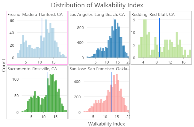

Alternatively, when a single Number variable is set, you can use the Split by drop-down menu to split the histogram into multiple series based on the number of unique categories in the field. For example, when displaying a histogram for a dataset related to housing prices, the Number control is set to SoldPrice to see the distribution of housing prices in a city. Setting the Split by control to Neighborhood splits the histogram into N series in which N is the number of unique neighborhood values. The multiple series histogram displays N mini charts, one for each unique Neighborhood value, so that the housing price distribution can be compared across the Split by values.
Note:
Category fields with many unique values are not appropriate for splitting a field into multiple series.
Multiple series histograms can only be displayed with a grid layout. The statistics displayed on the Data tab of the Chart Properties pane correspond to the summarized values for the selected mini chart. You can customize the dimensions of a grid chart layout by setting the Mini charts per row value on the Series tab of the Chart Properties pane. For example, setting Mini charts per row to 3 displays a maximum of three charts per row—the total number of rows in the grid is determined by the number of series in the chart. Check the Show preview chart check box to dynamically explore each mini chart in detail by choosing one to view in the larger preview chart.

Transformation
Some analytical methods require that data be normally distributed. When the data is skewed (the distribution is lopsided), you may want to transform the data to make it normal. Histograms allow you to explore the effects of data transformations on the distribution of data. For reference, you can add a normal distribution overlay to a histogram by checking the Show Normal distribution check box in the Chart properties pane.
Logarithmic transformation
The logarithmic transformation is often used when the data has a positively skewed distribution and there are a few large values. If these large values are located in the dataset, the log transformation will help make the variances more constant and normalize the data.

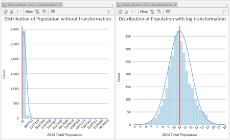

For example, the positively skewed distribution in the first chart below is transformed to a normal distribution using a logarithmic transformation in the second chart:
Two population charts

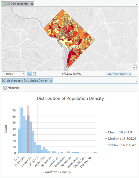

Example
The histogram below visualizes distribution of population density across Washington, D.C., census block groups using the following setting:
  • Number—Population Density
Histogram of population density
