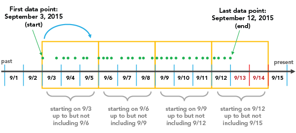

The Snap to first data point option initiates binning with the earliest date and works forward.
Binning with alignment at the start of the dataset

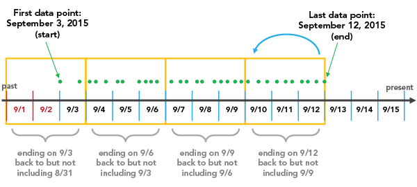

The Snap to last data point option initiates binning with the most recent date and works backward.
Binning with alignment at the end of the dataset

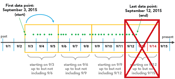

Interval alignment is important to consider because, depending on the configuration, partially empty bins may be created. Partially empty bins can give the misleading impression that there is a dip in the value or count during that time, when really the data collection began or ended during the span of that bin. To avoid bin bias, check the Trim incomplete interval option. This removes the partially filled bin from the visualization.

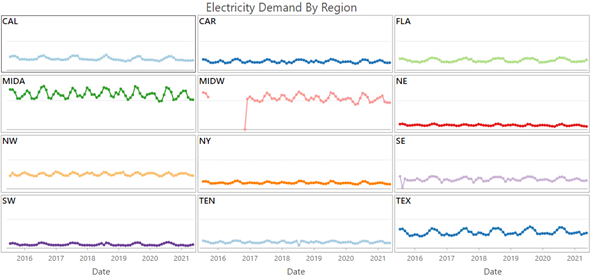

  • Grid Grid Chart—Each series is shown in a separate mini chart. This option is best for comparing patterns and trends across series without overlap. You can control the layout using the Mini charts per row input and explore individual charts by turning on the Show preview chart check box.
Line chart example

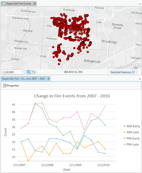

Create a line chart to visualize trends in fire events in Naperville from 2007 through 2010 using the following settings:
  • Date or Number—Date
  • Aggregation—Count
  • Time Interval Size—3 months
  • Split by—Time of day
Line chart showing trends in fire events in Naperville from 2007 through 2010
