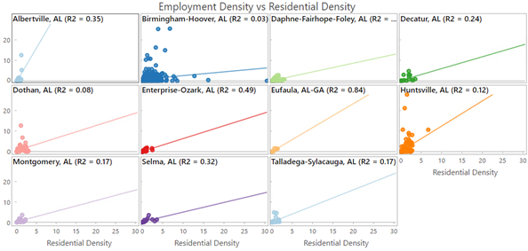

  • Grid Grid Chart—Each series is shown in a separate mini chart. This option is best for comparing patterns and trends across series without overlap. You can control the layout using the Mini charts per row input and explore individual charts by turning on the Show preview chart check box.
Grid chart example
Series statistics
When a multiple series scatter plot is configured with the Grid option, the mini charts can be displayed using the Scatterplots, R-Squared, or Pearson's r options from the Display drop-down list on the Series tab. When the R-Squared or Pearson's r option is selected, the mini charts will display the statistical value, and the background will reflect the gradient color specified in the Color scheme drop-down list, which corresponds to the strength of the value. Use the Sort by and Sort direction drop-down lists to order the mini charts alphabetically, manually, or by a statistical value.

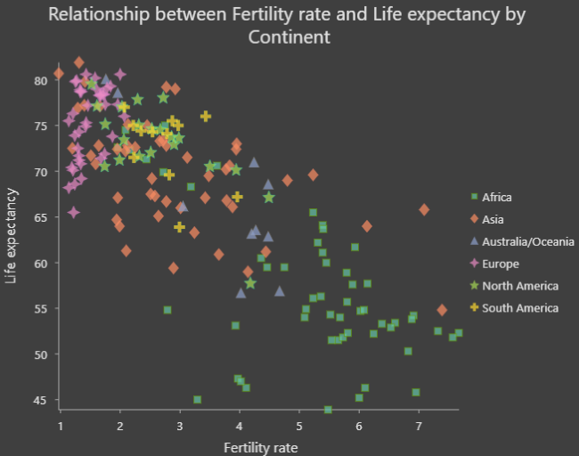

The point style can be customized on the Series tab in the Chart Properties pane by clicking the Symbol color patch in the Series table. Use the pop-up to configure the style, size, color, and transparency for point symbols. Alternatively, use the Color scheme drop-down list on the Series tab to apply a palette to the series in a chart.
Scatter plot in which each series is configured with a distinct marker shape

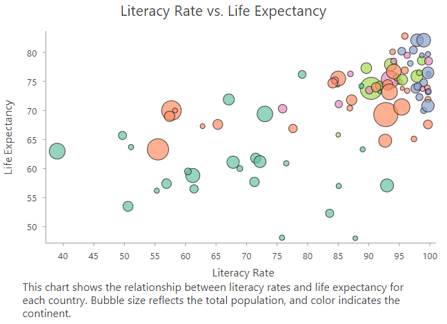

Proportional size
Use the Proportional drop-down list to size scatter plot points proportionally by a numeric attribute. Sizing scatter plot points proportionally based on a third numeric variable adds another dimension to the visualization, creating a bubble plot as shown in the following image:
Bubble chart example

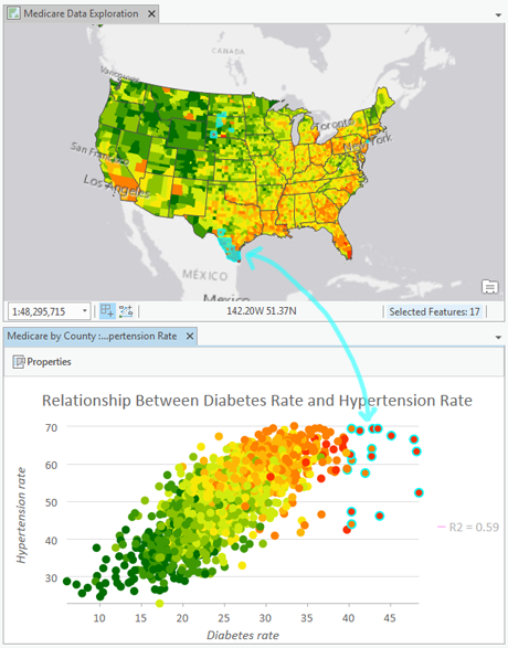

The scatter plot below visualizes the relationship between diabetes and hypertension among Medicare beneficiaries. Select features in the chart to see where they are located on the map.
  • X-Axis—Diabetes rate
  • Y-Axis—Hypertension rate
Scatter plot example
