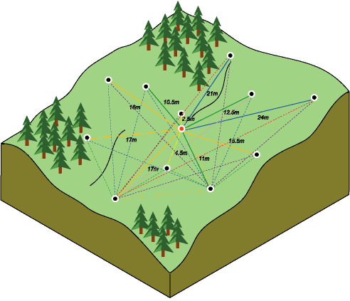

First, form pairs of points, and second, group the pairs so that they have a common distance and direction. In the landscape scene of 12 locations, you can see the pairing of all the locations with one location, the red point. Similar colors for the links between pairs indicate similar bin distances.
Pairing
This process continues for all possible pairs. You can see that, in the pairing process, the number of pairs increases rapidly with the addition of each location. This is why, for each bin, only the average distance and semivariance for all the pairs in that bin are plotted as a single point on the semivariogram.
