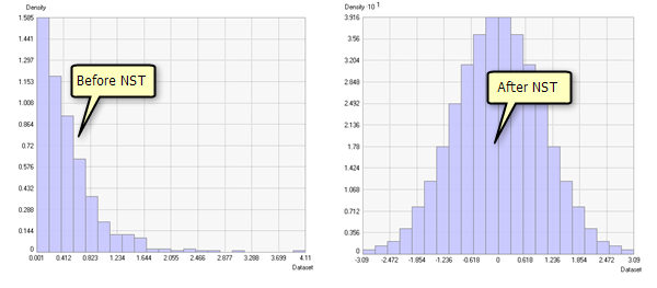

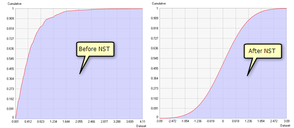

Examples showing histograms and cumulative distributions before and after a normal score transformation was applied are shown below:
Histograms before and after a normal score transformation
Cumulative distributions before and after a normal score transformation
