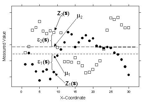

Notice that now you have two types of random errors, ε1(s) and ε2(s), so there is autocorrelation for each of them and cross-correlation between them. Ordinary cokriging attempts to predict Z1(s 0), just like ordinary kriging, but it uses information in the covariate Z2(s) in an attempt to do a better job. For example, the following figure has the same data that was used for ordinary kriging, only here a second variable is added.
Notice that Z1 and Z2 both appear autocorrelated. Also notice that when Z1 is below its mean µ1, then Z2 is often above its mean µ2, and vice versa. Thus, Z1 and Z2 appear to have negative cross-correlation. In this example, each location s had both Z1(s) and Z2(s); however, this is not necessary, and each variable type can have its own unique set of locations. The main variable of interest is Z1, and both autocorrelation and cross-correlation are used to make better predictions.
Cokriging graph example
