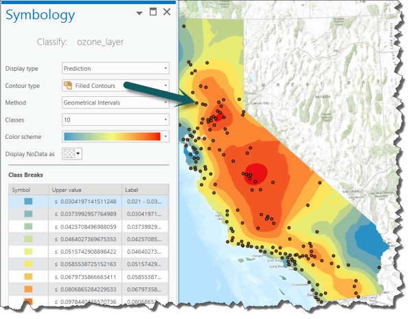

Filled contours
The image below shows the filled contours format.
Filled contours
A geostatistical layer is symbolized using the Filled Contours contour type.

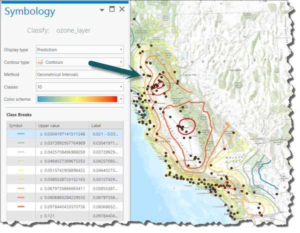

Contours
The image below shows the contours format.
Contours
A geostatistical layer is symbolized using the Contours contour type.
