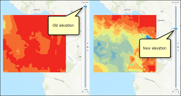

Geostatistical layers created by 3D interpolation methods can predict values at any location within the 3D extent of the layer. To allow you to explore the predicted values within this 3D volume, the layer is rendered as a horizontal slice at a given elevation. The layer automatically configures range properties so that the current elevation of the layer can be changed at any time with the range slider. When the elevation is changed, the layer updates and renders to reflect the predicted values at the new elevation. This allows you to use the range slider to iterate through different elevation values and see how the predictions change. Once an elevation value is specified, these layers are no different than any other geostatistical layer and support all of the options supported by geostatistical layers, including symbology, export options, and the ability to be edited in the Geostatistical Wizard.
The following image shows the same geostatistical layer before (left) and after (right) changing the elevation with the range slider:
Geostatistical layer rendered at two elevations.
The geostatistical layer is rendered at two elevations.

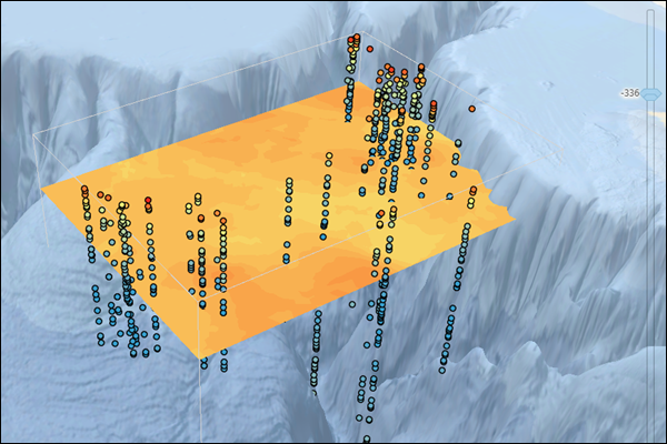

If a geostatistical layer created from a 3D interpolation method is added to a scene, the layer will render at the current elevation of the layer. Changing the elevation of the layer will shift the layer vertically to the new elevation. A wireframe box is drawn around the 3D extent of the layer to show the elevations that can be used. This box can be turned on and off on the Appearance ribbon tab of the layer.
Geostatistical layer in a Scene view
A geostatistical layer in a Scene view is shown.

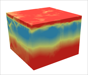

A 3D geostatistical layer can be exported to a netCDF (*.nc) file using the GA Layer 3D To NetCDF tool. The output netCDF file can then be used as the source for a voxel layer in a scene.
Geostatistical layer represented as a voxel layer.
A voxel layer exported from a 3D geostatistical layer is shown.

Geostatistical layer and predictions to gridded points in 3D
A geostatistical layer and predictions to gridded points in 3D are shown.
