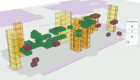

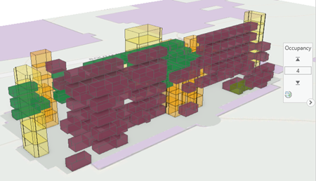

In the images below, the interior spaces are color-coded by use type. Yellow and orange spaces represent elevators and stairwells. Green and purple spaces represent different types of laboratory research rooms. The range slider can be used to see rooms by occupancy capacity per floor. For example, one room may have four microscope stations for four researchers.
Visualize room occupancy with a capacity of two. Visualize room occupancy with a capacity of four.
