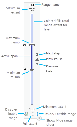

Range slider controls
To interact with the slider and its controls, move the pointer near the space where the slider is visible at the right of the map view. When not in use, it appears transparent and some controls are hidden. Hover over it or click it to bring it into focus. Minimize the slider to simplify its appearance and give the primary focus to the map or scene. When hidden, the range properties are still applied to what is displayed on the map. The range slider opens with range disabled by default. Click the Disable range button indicating map range is disabled on the slider to turn the range state on or off and filter data by range.
Controls on the full extent range slider Controls on the range slider in single value mode

Range slider item Description
Maximum thumb and Minimum thumb The thumbs set the bounds for the currently visible range. You can type values directly onto the slider or use the Current Range group on the Range tab. You can manually drag the thumbs as well.
Active span The span equals the difference between the maximum and minimum thumbs for the visible range.
Enable/Disable range , Disable Range Switch between displaying data based on the range constraints set using the range slider controls and displaying all the data without any range constraints.
Inside/Outside range , Outside Range Switch between displaying data within the defined range or outside the defined range. This option is only available when the slider is shown as a full extent slider control.
Full extent Full range extent Set the range extent of the slider to the full extent defined on the Range tab.
Show/Hide range slider Show or hide the range slider. Hiding the range slider does not automatically disable map range. The current range is still applied, and if the slider is playing, this continues as well.
Play/Pause Play a range animation that steps through ranges sequentially. Playback direction, speed, and whether to repeat or reverse can be configured from the Playback group on the Range tab. While playing, the Pause button displays in its place.
Next/Previous step Move forward or backward in the range by the amount defined in the step settings on the Range tab.
Maximum extent and Minimum extent The upper and lower values on the slider bar show the range extent of the range slider. You can modify the range extent of the slider by dragging the slider controls beyond the extent of the range slider, clicking the full range extent command, or rotating the wheel button over the range slider to zoom in and out.
Total range extent The colored fill in the slider bar represents the range extent as defined in the layer properties of one of more layers in the group.
