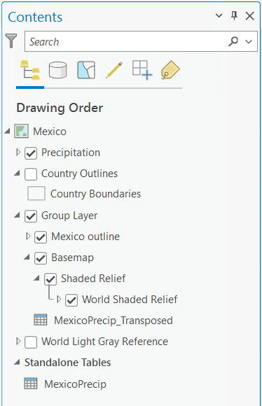

All layers and tables in a map or scene are listed in the Contents pane. Use this pane to manage the display of layers and tables, control their properties, and organize them into groups.
On the View tab, in the Windows group, click Contents
to open the pane, if necessary.
Contents pane tabs
The Contents pane tabs show unique information about the map or scene's layers. The active tab is indicated with a blue underline. Click each icon to switch between tabs.
Tip:
On any tab, press Ctrl while clicking to check or uncheck a box to select or deselect all layers simultaneously. For other tips, see Keyboard shortcuts in the Contents pane.
Use the tabs to view the contents of the map or scene in the following ways.

Drawing Order |
Arrange the layers in the order they display in the map. Layers at the top of the list draw above those below them. Drag a layer to position it in a different order in the list. Use the check box next to each layer to control its visibility. If the map uses scale-dependent drawing settings, a layer may be present in the drawing order and checked as visible but is not currently visible in the map's display. If a layer is out of range of the map's scale, it is indicated in the Contents pane with a grayed check box and a line underneath the box. The drawing order of the layers and tables in the pane is preserved each time the project is saved. You cannot return to a prior state of the drawing order in a session. In a scene, use the drawing order to organize layers into the 2D Layers or 3D Layers category. |
Data Source |
Group and manage layers and tables by their data sources. |
Selection |
Organize the layers that allow selection. When a selection is made, the number of features selected is shown next to the layer name. You can also clear the selection of any layer from this tab. Some layers, such as raster layers, do not allow interactive selection. These layers are listed without a selection check box. |
Editing |
Organize the layers and tables that can be edited. |
Snapping |
Organize the layers that can participate in snapping while working with tools that support snapping, such as those for editing and measuring features. |
Labeling |
Organize the visibility of label classes for each layer. Expand each layer to view the label classes, duplicate label classes, reorder them, access the labeling properties for each label class, copy the labeling properties between label classes, and change label properties for multiple label classes at the same time. Click the feature layer to select all of its label classes. |
