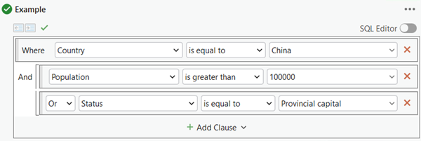

An example of a definition query.
This example definition query filters out city features in China that have less than 100,000 population or are not provincial capitals.
