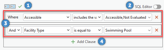

As shown in the image below, the interactive query builder contains various components:
Buttons to group
or ungroup
clauses. The green check mark
can be clicked to verify the syntax.A toggle button switches the builder to SQL Editor mode.
Preformatted drop-down menus to build each query interactively by choosing fields, operators, and values.
Add
and build clauses, and remove them
individually if they are no longer needed.
