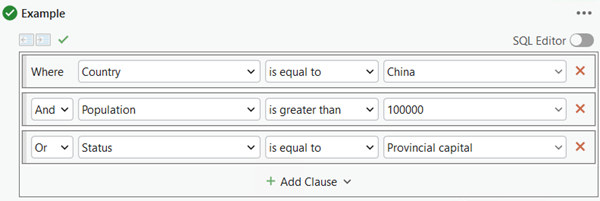

Ungrouped clauses
When you run this ungrouped query, it first finds all cities in China, and then filters Chinese cities that have more than 100,000 people. Next, based on the Or operator, it evaluates the entire dataset to return provincial capitals. The final results are Chinese cities larger than 100,000 people and any global city that is a provincial capital, which is not the intended result. This is because the And operator has a higher precedence than the Or operator, so And is evaluated first.
Three clauses in a query, ungrouped
