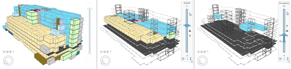

In the three images below, the range slider uses a range named Floor to filter the building interior spaces to a single floor. Then, a range filter named Occupancy is used to show rooms based on their occupancy.
Animate using multiple ranges.
Animate capturing multiple ranges.
