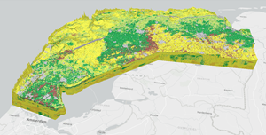

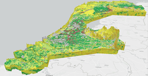

Voxel layers often cover large areas. There are various capabilities you can use to explore the voxel layer in detail. Voxel layers can be visualized as volumes or surfaces. You can define an area of interest using slices to view the volume for a specific area rather than the entire dataset.
Underground model of the Netherlands viewed as a volume A sliced voxel layer

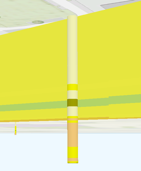

You can explore the surfaces of a voxel layer. You can create sections to understand structures in the voxel layer. For example, you can create a cross section diagram to explore an underground model at locations where new construction is planned. You can show a voxel layer together with other GIS content. For example, to show the impact of the underground model to a construction area, measure the thickness of a geological formation or show the underground model together with boreholes.
A section from an underground model together with a borehole
A section from an underground model together with a borehole is shown in this sample set of the GeoTOP model from TNO - Geological Survey of the Netherlands.

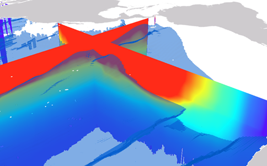

When a variable is continuous, you can create a surface along a specific value represented as an isosurface. Sections and isosurfaces can be shown together. For example, you can explore a voxel layer by creating cross section diagrams, or in the case of quantitative data, isosurfaces.
Ecological marine unit voxel layer showing nitrate concentration as an isosurface and a cross section
The ecological marine unit voxel layer shows nitrate concentration as an isosurface and a cross section.

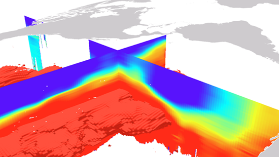

You can compare information recorded in variables for an individual voxel cube. To explore variables together, you can lock sections to create a snapshot for a variable and examine it together with isosurfaces of another variable. For example, you can explore the relationship between water temperature and oxygen level. Create locked sections showing a temperature cross section diagram and create isosurfaces of different oxygen levels to see the spatial relationship between the two variables.
Ecological marine unit voxel layer showing a cross section of temperature with an isosurface of oxygen saturation
The ecological marine unit voxel layer shows a cross section of temperature with an isosurface of oxygen saturation.

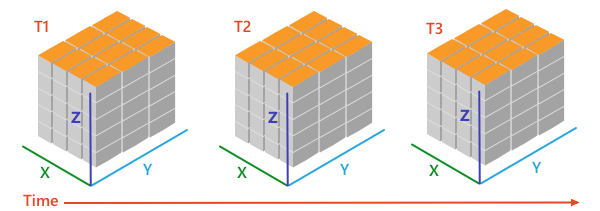

  • X, Y, T in which X and Y represent a geographic coordinate and T represents time as a level. An example for this type of dimension is the space-time cube.
X, Y, T dimension
  • X, Y, Z ,T in which each dimension represents geographic coordinates and includes a fourth dimension representing time.
X, Y, Z ,T dimension
