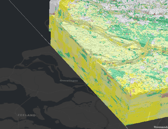

Vertical slice results
The result of the vertical slice is shown. Data courtesy of TNO geological survey of The Netherlands.
