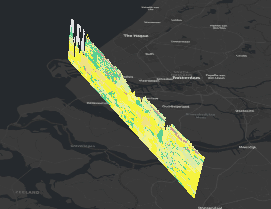

Vertical section result
The result of creating a vertical section is shown. Data courtesy of TNO geological survey of The Netherlands.

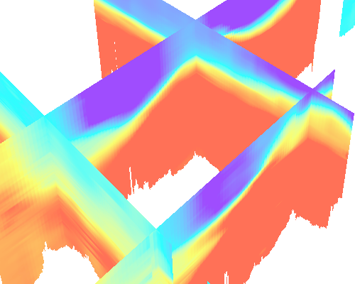

Cross section of ecological marine unit voxel layer
A cross section of an ecological marine unit voxel layer is shown.
