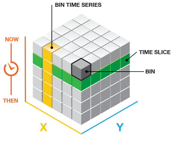

  • This tool aggregates point input features into space-time bins. The data structure it creates can be thought of as a three-dimensional cube composed of space-time bins with the x and y dimensions representing space and the t dimension representing time.

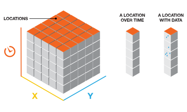

    Space-time bins in a three-dimensional cube
  • Every bin has a fixed position in space (x,y) and in time (t). Bins covering the same (x,y) area share the same location ID. Bins encompassing the same duration share the same time-step ID.
    Locations in the space-time cube
  • Each bin in the space-time cube has a LOCATION_ID, time_step_ID, and COUNT field value, as well as values for any fields specified in the Summary Fields parameter that were aggregated when the cube was created. Bins associated with the same physical location will share the same location ID and together will represent a time series. Bins associated with the same time-step interval will share the same time-step ID and together will comprise a time slice. The count value for each bin reflects the number of points that occurred at the associated location within the associated time-step interval.
