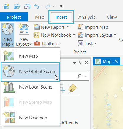

  2. Open a scene. To open a scene so the results of the tool can be rendered in 3D, click the Insert tab, click New Map, and choose a new global or local scene.
    Open a new scene.
