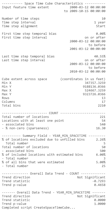

A number of outputs are created by this tool. The 2D map, with the categories defined above, provides the most prominent output. In addition, messages summarizing the analysis results are written at the bottom of the Geoprocessing pane during tool processing. You can access the messages by hovering over the progress bar, clicking pop out , or expanding the messages section in the Geoprocessing pane. You can also access the messages for a previously run tool through the geoprocessing history.
Emerging Hot Spot Analysis message example
