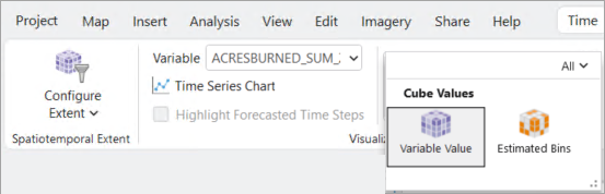

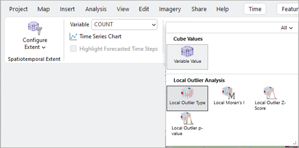

Cube Values
The display themes in the Cube Values section allow you to visualize the raw cube values and the locations with estimated bins.
The Cube Values section in the Theme gallery
Variable Value
The Variable Value theme displays the space-time bins symbolized by the values of the cube variable selected. You can set the Range Options drop-down menu in the space-time cube ribbon, then adjust the range slider values to display only those space-time bins with selected cube variable values that fall within a certain range.
The Variable Value display theme applied to a space-time cube.

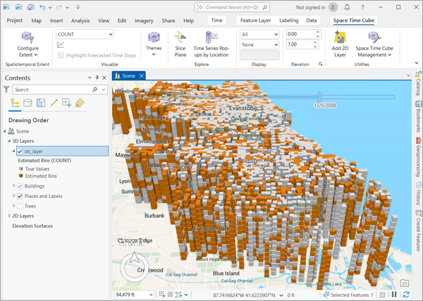

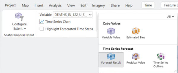

Estimated Bins
The Estimated Bins theme displays the space-time bins symbolized by whether they were estimated (orange) or contain true values (gray). This allows you to explore patterns of estimated (imputed) values across space and time. Values will be estimates if Summary Fields or Variables values were aggregated when the space-time cube was created by the Create Space Time Cube By Aggregating Points or Create Space Time Cube From Defined Locations tool. This option is not available for the raw COUNT variable in any space-time cube because the COUNT variable is never an estimate.
The Estimated Bins display theme applied to a space-time cube.
Local Outlier Analysis
The display themes in the Local Outlier Analysis section allow you to visualize the analysis results from the Local Outlier Analysis tool. Use these themes to explore the statistically significant clusters and outliers across space and time.
The Local Outlier Analysis section in the Theme gallery

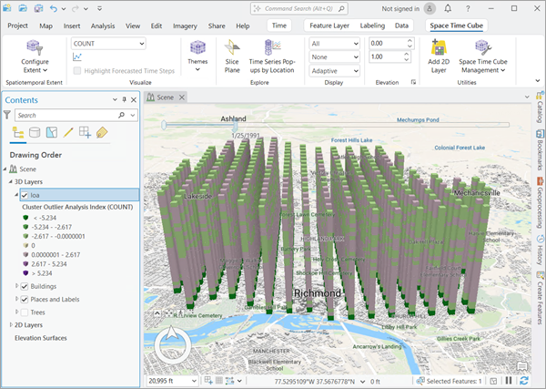

Local Outlier Type
The Local Outlier Type theme displays the space-time bins symbolized by the cluster-outlier type of the selected cube variable. Use this theme to locate statistically significant (at the 95 percent confidence level) clusters and outliers.
The Local Outlier Type display theme applied to a space-time cube.

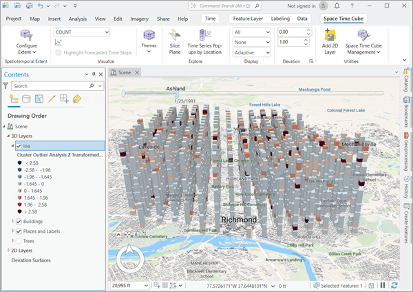

Local Outlier Z-Score
The Local Outlier Z-Score theme displays all the space-time bins in the cube symbolized by their z-scores. Set the Range Options drop-down menu then use the range slider to explore a specific level or range of clustering intensity.
The Local Outlier Z-Score display theme applied to a space-time cube.

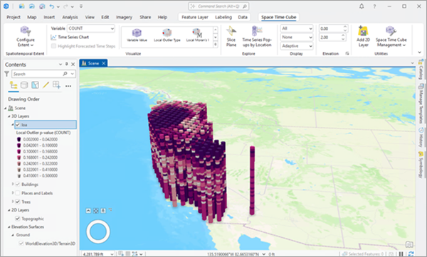

Local Outlier p-value
The Local Outlier p-value theme displays all the space-time bins in the cube symbolized by their p-values. Set the Range Options drop-down menu then use the range slider to explore a specific level or range of statistical significance.
The Local Outlier p-value display theme applied to a space-time cube.

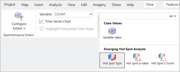

Emerging Hot Spot Analysis
The display themes in the Emerging Hot Spot Analysis section allow you to visualize the results from the Emerging Hot Spot tool so you can explore the distribution of hot spots and cold spots across space and time.
The Emerging Hot Spot Analysis section in the Theme gallery
Hot Spot Type
The Hot Spot Type theme displays the space-time bins symbolized by the hot spot type of the selected cube variable. Bins are colored by their hot spot significance.
The Hot Spot Type display theme applied to a space-time cube.

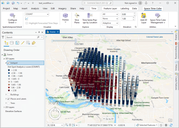

Hot Spot Z-Score
The Hot Spot Z-score theme displays the space-time bins symbolized by their z-scores. Set the Range Options drop-down menu, then use the range slider to explore a specific level or range of hot spot intensity.
The Hot Spot Z-score display theme applied to a space-time cube.

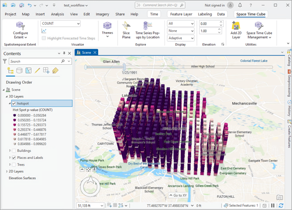

Hot Spot p-value
The Hot Spot p-value theme displays the space-time bins symbolized by their p-values. Set the Range Options drop-down menu then use the range slider to explore a specific level or range of statistical significance.
The Hot Spot p-value display theme applied to a space-time cube.

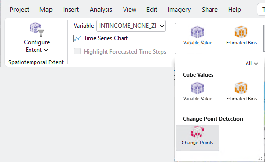

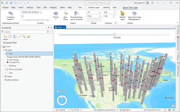

Change Point Detection
The display theme in the Change Point Detection section allows you to visualize the results from the Change Point Detection tool so you can explore when change points occur.
The Change Point Detection section in the Theme gallery
The Change Points theme displays all the space-time bins and highlights the bins in each location where a change point is detected.
The Change Points display theme applied to a space-time cube.
Time Series Forecast
The display themes in the Time Series Forecast section allow you to visualize the forecast results from the tools in the Time Series Forecasting toolset.
The Time Series Forecast section in the Theme gallery

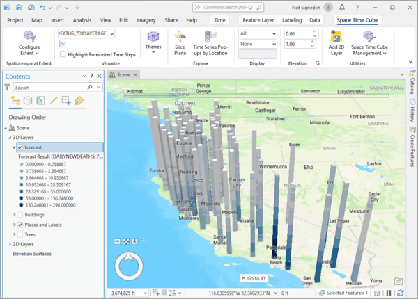

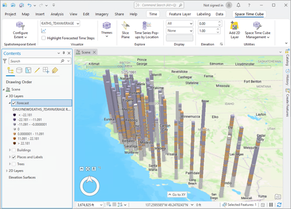

Forecast Result
The Forecast Result theme displays the space-time bins symbolized by the predicted values of the selected variable.
The Forecast Result display theme applied to a space-time cube.

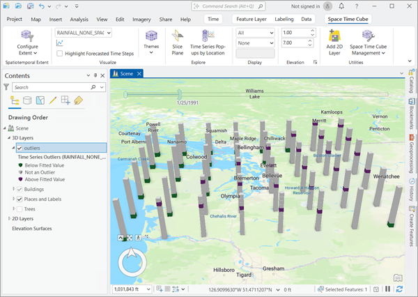

Time Series Outliers
The Time Series Outliers theme displays all the space-time bins and highlights the outlier bins at each location in the input space-time cube. This theme only applies to space-time cubes that are output by the tools in the Time Series Forecasting toolset and that set the Outlier Option parameter value to Identify outliers.
The Time Series Outliers display theme applied to a space-time cube.

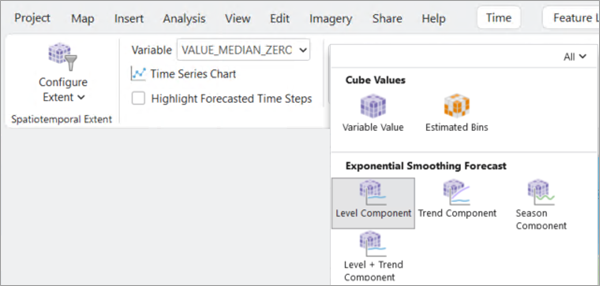

Exponential Smoothing Forecast
The display themes in the Exponential Smoothing Forecast section allow you to visualize the results from the Exponential Smoothing Forecast tool so you can explore the components of the decomposed time series.
The Exponential Smoothing Forecast section in the Theme gallery

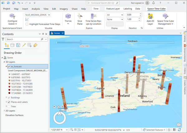

Level Component
The Level Component theme displays the level component value of each bin.
The Level Component display theme applied to a space-time cube.

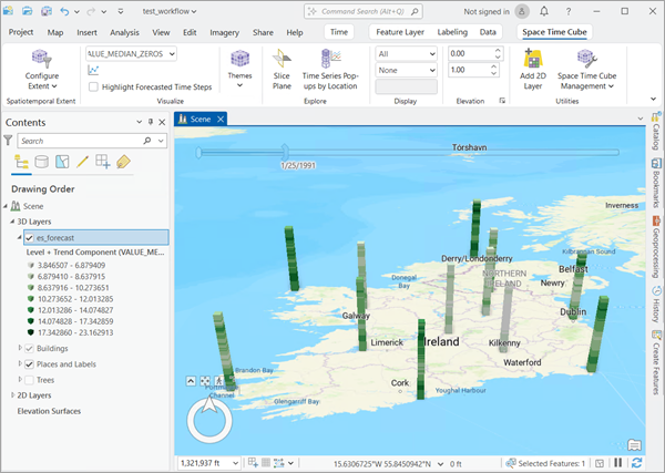

Level + Trend Component
The Level + Trend Component theme displays the sum of the level and trend component values of each bin.
The Level + Trend Component display theme applied to a space-time cube.
