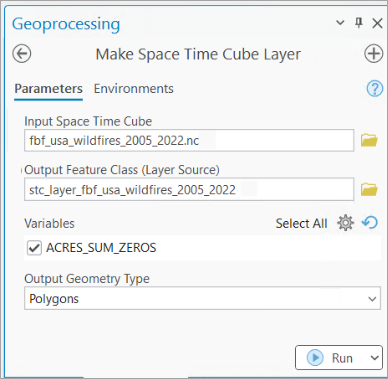

Create a space-time cube layer
To create a space-time cube layer, you must use the Make Space Time Cube Layer tool. You can access the tool from the Geoprocessing pane or the Map tab.
To create a space-time cube layer, complete the following steps:
  1. On the Map tab, click Add Data, and from the drop-down menu, click Space Time Cube Layer.
    The Make Space Time Cube Layer tool opens.
  2. Specify the parameters as follows:
    Make Space Time Cube Layer geoprocessing tool
  3. Click Run to run the tool.
    A space-time cube layer is created and added to the Contents pane. The space-time cube will be displayed in the 3D scene.

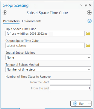

  9. In the Data Management section, click the Space Time Cube Management drop-down menu, and click Subset Cube.
    The Subset Space Time Cube tool opens.
  10. To remove the forecasted time steps, specify the parameters as follows:
    Subset Space Time Cube geoprocessing tool
  11. Click Run to run the tool.
