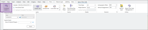

Configure the spatiotemporal extent
By default, the space-time cube layer’s full extent will be displayed. The spatial extent is the area covered by all the locations. The time extent is the start time of the first bin to the end time of the final bin. However, you may only be interested in a particular region or time span. For example, the space-time cube may contain 10 years of rainfall measurements collected across the United States, however, you’re only interested in rainfall in California over the last two years. The Configure Extent control on the Space Time Cube ribbon allows you to set the spatial and temporal extent that is visualized in the scene.
The Spatiotemporal Extent group on the Space Time Cube ribbon
Note:
Configuring the temporal and spatial extent applies a definition query to the space-time cube. This only impacts the visualization. The space-time cube will not be changed.
To constrain the time extent, set the Start and End time in the Temporal Extent parameter. To constrain the spatial extent, set the Area of Interest parameter. Every space-time cube location that intersects with the area of interest layer will be displayed. If a subset of the features in the layer are selected, only those features will be used. The layer specified as the Area of Interest must be visible and checked in the Contents pane. You can reset the spatial extent by clicking the reset button. Once you click Apply, the temporal and spatial extent of the space-time cube layer will update in the scene and in the layer’s attribute table. The Temporal Extent will impact the chart created by the Time Series Chart control. It does not impact the pop-up charts that appear when the Time Series Pop-ups by Location control is selected and a bin is clicked.
