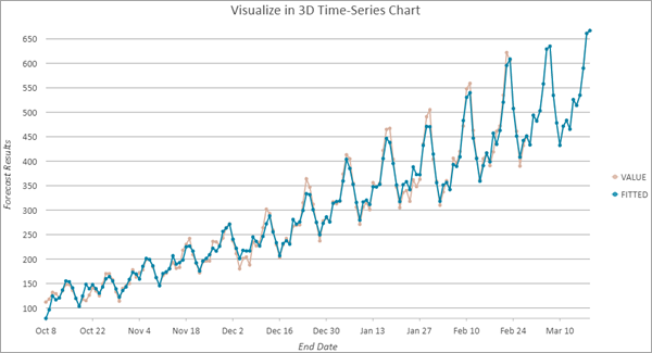

Illustration
Exponential Smoothing Forecast tool illustration
The Exponential Smoothing Forecast tool is used to predict the values of future time steps.
