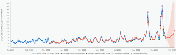

Clicking an output feature on the map produces a pop-up chart in the Pop-up pane that displays the time series and forecast model with identified outliers displayed as large points. The following image shows the time series of a feature in which one outlier was identified:
Pop-up time series outlier chart
The pop-up chart displays the time series with outliers identified.

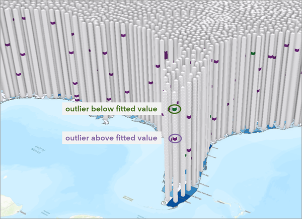

For 3D feature output, the output features display the locations and times of the identified outliers in a 3D scene. Any space-time bin whose value is identified as a time series outlier is labeled as Above Fitted Value or Below Fitted Value, depending on whether the value is above or below the fitted values of the forecast model. Outliers above the fitted value display in purple, and outliers below the fitted value display in green. Space-time bins not identified as outliers are labeled Not an Outlier and display in light gray.
3D features displaying outliers above and below fit
Outliers above and below fitted values are shown in the 3D features.

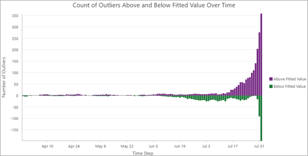

The second chart is the Count of Outliers Above or Below Fitted Value Over Time chart. This chart is a stacked bar chart displaying the total number of outliers above and below fit at each time step of the space-time cube. This allows you to identify important dates when many outliers occurred, and you can see if the values on these dates were unusually high or low.
Bar chart of outliers above and below fitted values
The stacked bar chart shows the counts of outliers above and below fitted values over time.

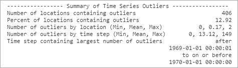

The geoprocessing messages include a Summary of Time Series Outliers section. The first part of this section shows the number and percent of locations containing at least one outlier. This allows you a quick sense of how well the forecast model fits the time series overall. The second part displays summary statistics (minimum, mean, and maximum) of the number of outliers per location and per time step. This allows you to investigate how frequently outliers occurred at individual locations and individual time steps. This section also displays the time step containing the largest number of outliers. You can use this to identify important dates when many outliers occurred.
Messages summarizing the identified outliers
Summaries of the identified outliers appear in the geoprocessing messages.

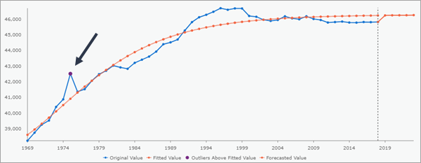

The simplest type is global outliers whose raw values are significantly larger or smaller than the rest of the values. These outliers often correspond to anomalies or special events such as holidays. The chart below shows a global outlier. The identified outlier has a significantly higher value than the rest of the data in the times series and was identified because of this.
Global time series outlier

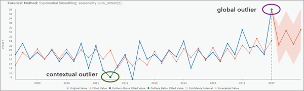

However, values do not need to be among the largest or smallest in the time series to be declared outliers. Instead, some outliers are identified based on context, by having a significantly higher or lower value than you would expect based on the patterns and trends of the time series. The forecast model incorporates these patterns and trends, and it serves as the baseline for identifying contextual outliers. For example, consider a time series of annual mean temperature. Because average temperatures have increased over the last several decades, the fitted forecast model of temperature also increases over time to reflect this increase. This means that a temperature value that would be considered typical and not an outlier in 1950 would likely be considered an outlier if the same temperature occurred in 2020. In other words, a typical temperature from 1950 would be considered low by the standards of 2020.

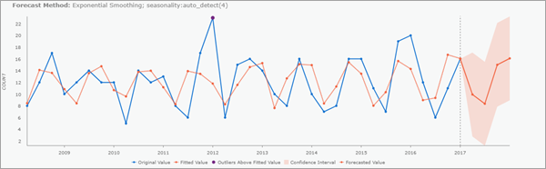

The chart below shows a time series with both a contextual outlier and a global outlier. The value of the contextual outlier is not the smallest in the time series, but it was identified as a low value outlier because it fell farthest below the orange forecast model.
Contextual and global time series outliers
