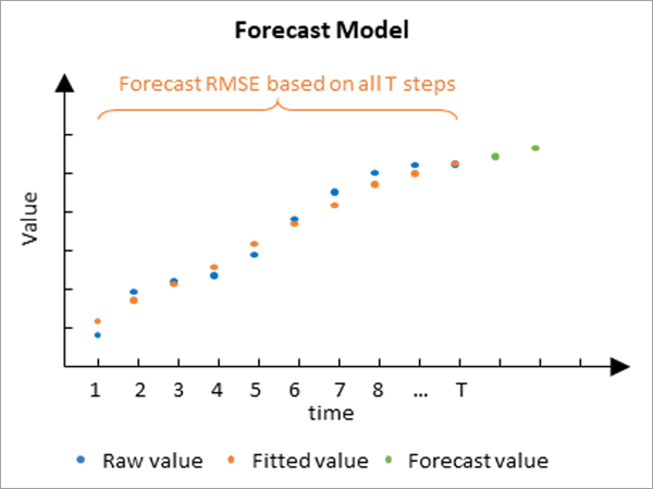

The following image shows the raw values of a time series and an exponential smoothing model fitted to the time series along with forecasts for two future time steps. The Forecast RMSE measures how much the fitted values from the model differ from the raw time series values.
Forecast model for Exponential Smoothing Forecast
The Forecast RMSE only measures how well the exponential smoothing model fits the raw time series values. It does not measure how well the forecast model actually forecasts future values. It is common for models to fit a time series closely but not provide accurate forecasts when extrapolated. This problem is addressed by the validation model.

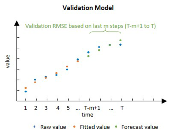

The following image shows an exponential smoothing model fitted to the first half of a time series and used to predict the second half of the time series. The Validation RMSE measures how much the forecasted values differ from the raw values at the withheld time steps.
Validation model for Exponential Smoothing Forecast
The validation model is important because it can directly compare forecasted values to raw values to measure how well the exponential smoothing model can forecast. While it is not actually used to forecast, it is used to justify the forecast model.

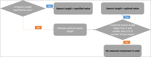

If you know the number of time steps that correspond to one season in your data, you can specify it in the Season Length parameter, and this value will be used by every location in the space-time cube. If you do not know the length of a season or if the seasonal length is different for different locations, the parameter value can be left empty, and an optimal season length will be estimated for each location using a spectral density function. For details about this function, see the Additional resources section.
For an individual location, if the optimal season length determined by spectral analysis is greater than one and less than one-third of the number of time steps at the location, the season length is set to this optimal value. Otherwise, the location does not use a seasonal component. The season length used at the location is saved in the Season Length field of the output features. If a seasonal component is not used, the value in this field is 1. This workflow is summarized in the following image:
Determining the Season Length parameter.
The Season Length can be specified or estimated for each location.

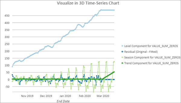

Visualize the components
You can visualize the components of your exponential smoothing model by creating an output space-time cube. Use this cube in the Make Space Time Cube Layer tool to create a space-time cube layer. On the space-time cube ribbon, set the Display Theme parameter to the Forecast results option. A chart is created for the output features, and the various components of the exponential smoothing model can be turned on and off in the Chart Properties pane. When these components are added together, they construct the forecast model and the forecasts for the future time steps. The following image shows the individual components of the exponential smoothing model shown in the first image of this topic:
Components of exponential smoothing.
The exponential smoothing model is separated into several components.

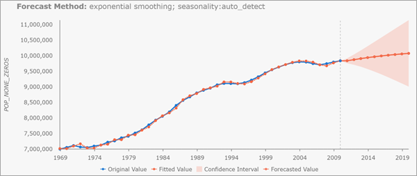

Clicking any feature on the map using the Explore navigation tool displays a chart in the Pop-up pane showing the values of the space-time cube along with the fitted exponential smoothing model and the forecasted values along with 90 percent confidence intervals for each forecast. The values of the space-time cube are displayed in blue and are connected by a blue line. The fitted values are displayed in orange and are connected by a dashed orange line. The forecasted values are displayed in orange and are connected by a solid orange line representing the forecasting of the model. Light red confidence bounds are drawn around each forecasted value. You can hover over any point in the chart to see the date and value of the point. Additionally, if you chose to detect outliers in time series, any outliers are displayed as large purple dots.
Exponential Smoothing Forecast pop-up chart
The pop-up chart displays the original values, fitted values, forecasted values, and confidence intervals.
