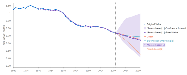

Evaluate Forecasts By Location tool illustration
Multiple forecasts are displayed with the most accurate forecast highlighted in the legend.

  • This tool creates geoprocessing messages and interactive pop-up charts to help you understand and visualize the results. The messages contain information about the structure of the space-time cube, summary statistics of the RMSE values, and summaries of the number of locations represented by each forecast method. Clicking a feature using the Explore tool displays a line chart in the Pop-up pane showing the values of the space-time cube and the forecasted values of each forecast method. The forecast method selected at the location is highlighted in the chart.
