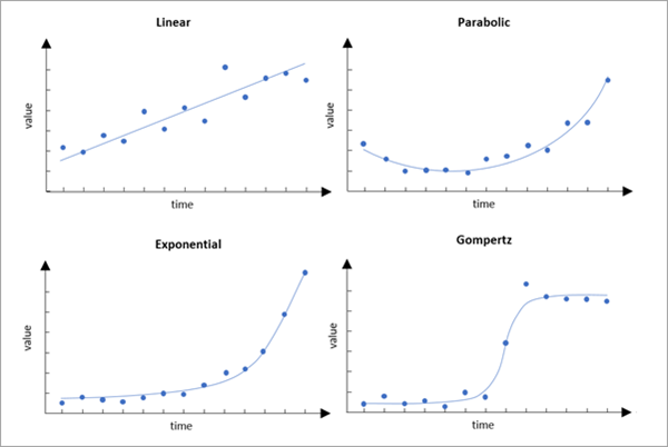

Illustration
Curve Fit Forecast tool illustration
Four curve types are shown.
