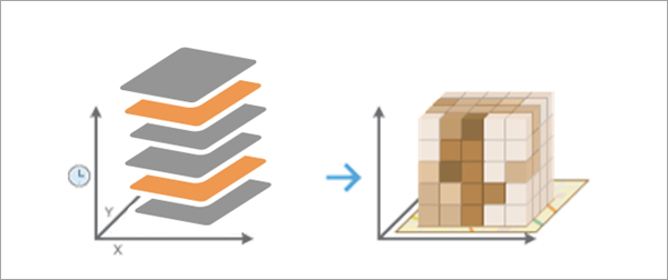

Illustration
Create Space Time Cube From Multidimensional Raster Layer tool illustration
Create a space-time cube from a multidimensional raster layer.

  • The Output Space Time Cube value will be created using the spatial and temporal resolution of the Input Multidimensional Raster Layer parameter value. Each space-time bin in the output cube will refer to a single raster cell for a single time interval from the input. Bins sharing the same location will have the same Location ID attribute, and bins sharing the same time interval will have the same Time Step ID attribute.
  • This tool is similar to the Create Space Time Cube From Defined Locations and Create Space Time Cube By Aggregating Points tools, except no spatial or temporal aggregation is used in this tool for the conversion. The locations of the space-time cube are the same as the individual raster cells, and the time intervals of the cube are the same as the time intervals of the raster.
