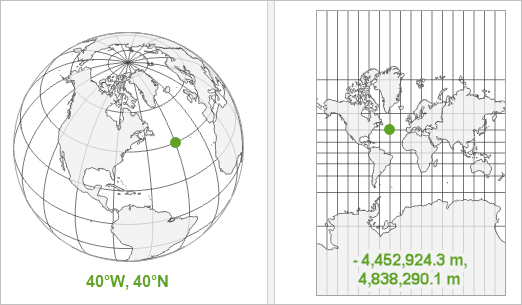

A diagrammatic comparison of a geographic coordinate system appearing as a spherical globe and a projected coordinate system appearing as a rectangular flat map
A geographic coordinate system (left) measured in angular units is compared to a projected coordinate system (right) measured in linear units (meters) for the same location in the Atlantic Ocean.
