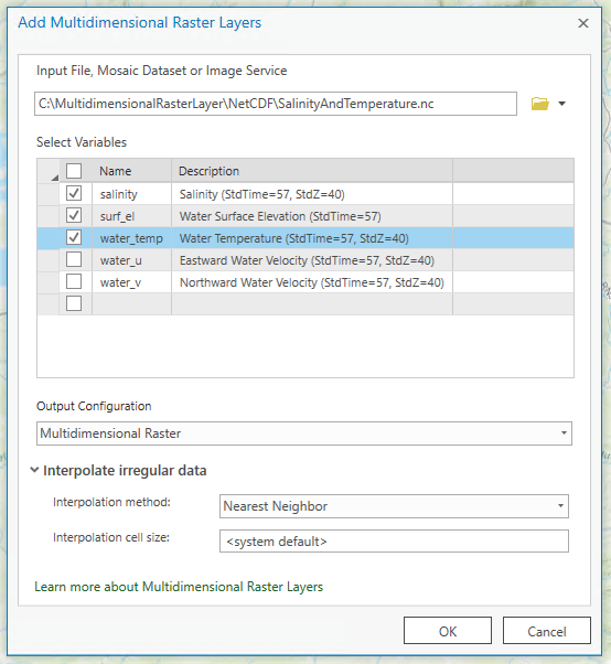

  5. On the Add Multidimensional Raster Layers dialog box, in the Select Variables table, select one or multiple variables.
  6. Choose an Output Configuration option and, optionally, the interpolation method, and click OK.
