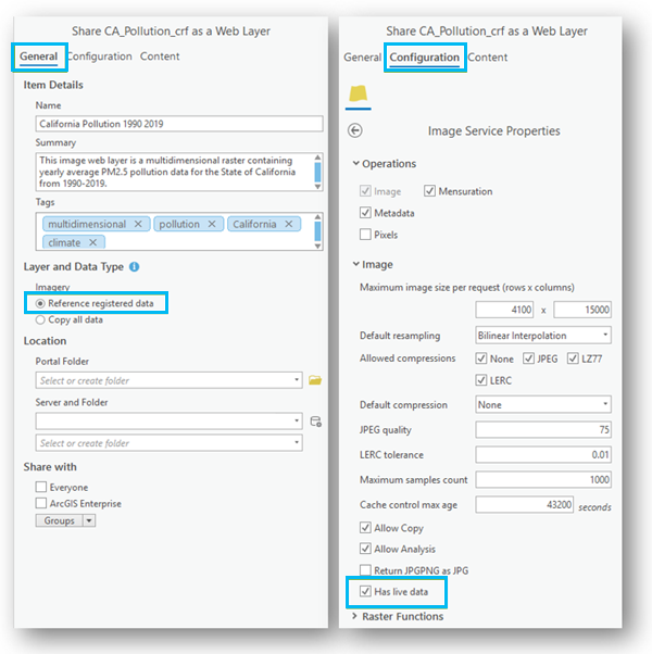

If you want to update the source multidimensional dataset and have those updates reflected in the image service, use the following settings:
  • For both CRF and mosaic datasets—On the General tab of the Share As Web Layer pane, set the Layer and Data Type option to Reference registered data. The web layer will be generated by referencing the source dataset.
  • For CRF only—On the Configuration tab of the Share As Web Layer pane, click the Configure Web Layer Properties button for your image layer and check the Has live data check box. The image service will be updated when the source CRF is updated. This is not required for a multidimensional mosaic dataset.
Recommended settings in Share As Web Layer pane for image services to be updated
