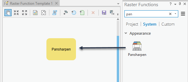

Add raster functions
Raster functions are fundamental building blocks of your raster function template. There are many raster functions you can use for your imagery and raster related tasks. Once you know the functions needed for your task, you can add those functions to a raster function template.
To add a function to your raster function template, drag the function from the Raster Functions pane into the template. Optionally, you can right-click any function or template and click Add to Function Editor. The raster function is added to the function template and displays as a yellow rounded rectangle.
Pansharpen function in the template

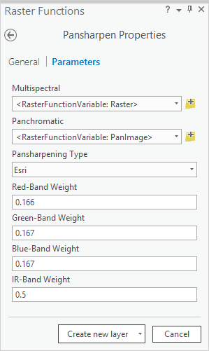

Change function parameters
Double-click the Pansharpen function to open the function property page. You can edit parameters on the Parameters tab. After specifying your parameters, click OK to close the Properties window. The function does not run when you click OK, it only saves the function settings.
Tip:
Another way to access the function properties is to right-click the function and click Properties.
Pansharpen parameters

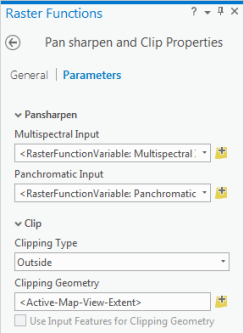

Apply a raster function template
When an end user opens the template, it opens to a pane showing what parameters have been set to public and will require the inputs to be specified. The following example template has four parameters set to public: two from each of the functions. Parameters are automatically grouped under each function in the chain that has public variables.
Raster function template parameters
