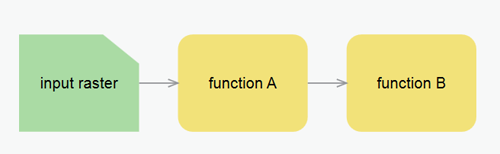

    • Processing Path (Qualified by Function Name)—Returns every possible path to each item in each selected raster’s function chain by name. A function can exist more than once in the same chain, but you may want to insert a new function on top of only one of them. The path in the function chain provides helpful context when distinguishing between multiple occurrences of a function in the chain because the Processing Path list contains every possible path to each function. Consequently, the list can be long since there may be multiple paths to the same function.
      Note:
      The paths are displayed starting with the last function in the chain and moving back toward the input raster or rasters. If you are inserting a new function, it will be inserted after the function that you select. For example, if you want to add a new function after function A in the function chain below, choose the processing path in the search results that looks like the following: function B.Raster \ function A
      Function chain example
      The new function or functions will be inserted between function A and function B.

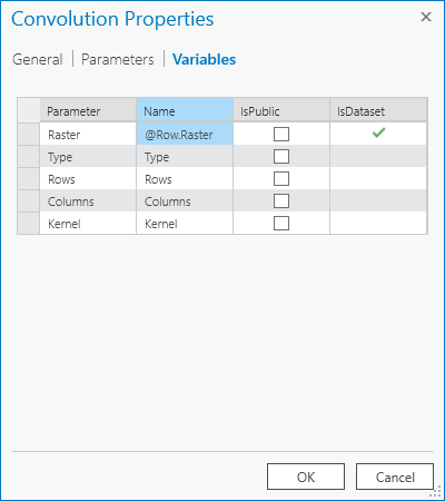

    • If you chose Insert Raster Function(s), the function editor will contain a raster variable when it opens. Build or import the function template you want to insert. The new function template will be inserted on top of the function or functions you selected on the previous page of the wizard.
      Note:
      If you build your function template outside of the batch editor and want to import it, make sure you refer to the input raster using @Row.Raster in the function variable manager. This will ensure that the raster represented by the selected record in the mosaic dataset will be used as the input. If you build the template in the batch editor, the variable name will be set automatically.
      Convolution variable properties
